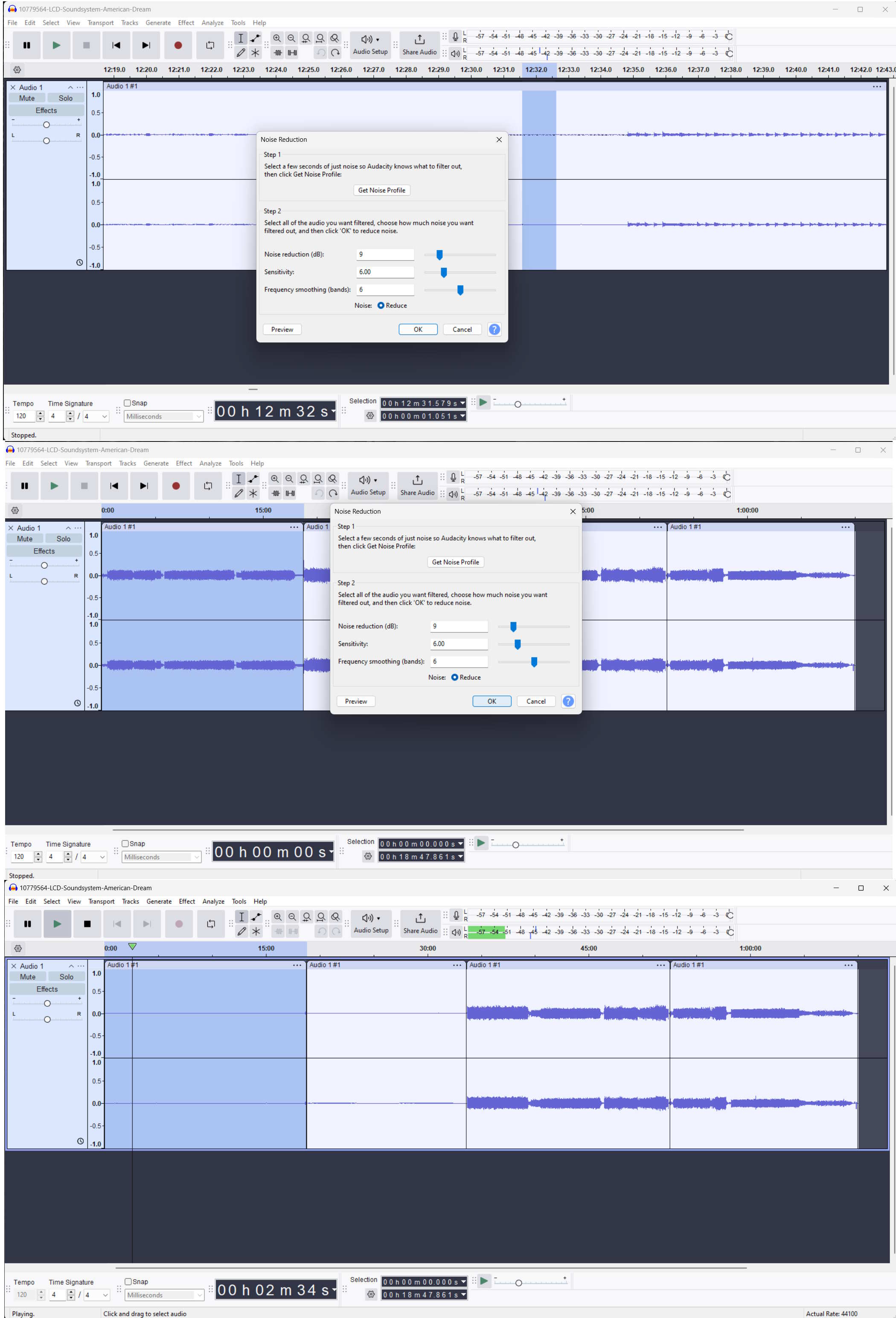

Here is a strange one: I have a project file - a recording of one of my vinyl for private use - where I can not apply Noise Reduction properly. This happens with this one project file only; for other files NR works fine. So i guess, we are looking at a somehow corrupted project file? Any help is highly appreciated.
Attached you will find screenshots of all the usual steps and the results. I am not looking for tips on how to apply NR. I know how. I am looking for ideas towards restoring the project file work properly again or related issues.
Thank you!
First the base nr profile area is selected and set. Then the area for application is selected and the nr applied. After the usual few seconds of application nr is done, resulting in the selected - but also a not selected part of the recording - to be almost completly flatlined. There still is a minimal signal (at about -55db).
As stated, this is not reproducible in other project files. It happens in other parts of the project file though, too.
Appendum: when selecting the audio clips and pasting them into a new project file (as the manual suggests, this should only transfer the audio data from the selection) the same behaviour is present. Strange.
Appendum 2: Alright, this might be an UI/selection related bug. The behaviour described above happened when selecting parts of the clip by clicking on the top handle of the edit - automatically selecting the audio clip from In- to Out-Point.
Now, when selecting the clip by hand, NR runs through normally as expected, applying NR properly on the selected area.
