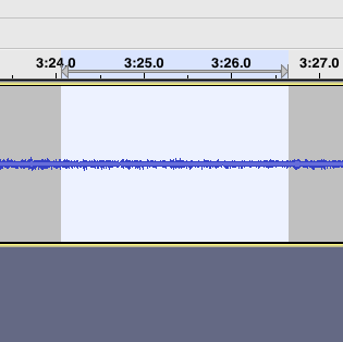

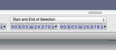

Select a chunk of the sample between these two times (mostly noise).
Effect > Noise Reduction > Profile.
Select the whole clip (select button on the left).
Effect > Noise Reduction 18, 6, 6 > Enter.
That’s only likely to help the first third of the clip. That’s the basic dance for Noise Reduction. Let it
“sniff” the noise and use that sample as a goal for reduction.
