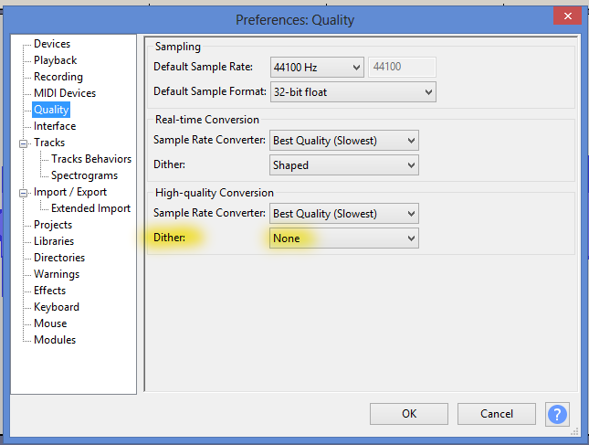

Try switching off dither, (in preferences) …
When an analog signal is digitized you get [u]quantization noise[/u] (the result of “quantization error”.). It’s inaudible at 16-bits but at 8-bits you can hear it. It “lives in the background” like regular-old analog noise so it’s most noticeable with quiet sounds. However, unlike analog noise it goes-away with “true digital silence”.
Dither is intentionally-added noise that’s supposed to be preferable to quantization noise.
Thanks for the tip, but the noise is still there.
Oh, now I see, it’s the technical nuance of the 8-bit audio. The noise disappears on 16-bits indeed. Thanks for the explanation!
