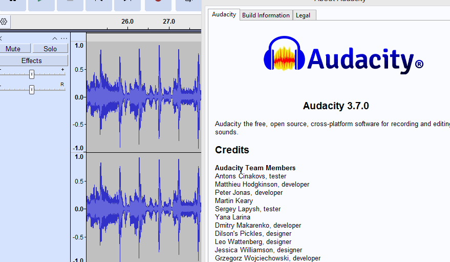

Gate in 3.7.0 is working for me …
It’s possible to adjust the gate settings so it will do nothing.
