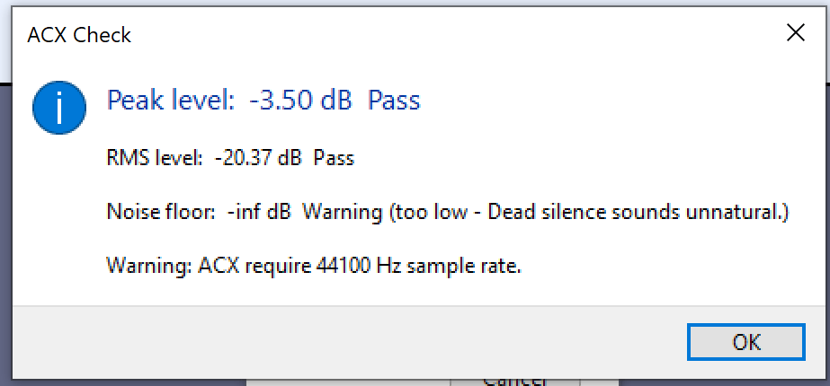

One of my voice actors has turned in two files that sound fine to me but hit the “noise floor too low” error on ACX Check. I’m having trouble finding a fix. Every article I find is about reducing the noise floor, not increasing it.
I created a brownian noise track, but when I ran ACX Check, it paused halfway through to give me a FAIL then finished and gave me a second FAIL.

Now the question is what happened? Did you over-do noise reduction or use a noise gate or something?
This is the wrong approach. You need to find out why the noise floor is measuring too low, then fix that. Most likely it is just one, or a few tiny sections of the file that are faulty. Adding noise to the entire track will make it sound worse, and “what it sounds like” is far more important than measurements.
What is the full and exact message? How low does it say the noise floor is?
ACX Check measures the whole show and then reports the quietest portion. So if you created an absolutely perfect book chapter but then jammed on a couple of seconds of Generate > Silence, the whole chapter will most likely fail Too Quiet. As an experiment, select the middle third of one of those “faulty” chapters and analyze that. A repair might be just getting Room Tone from the show and copy that on the ends of the chapter instead of Generate > Silence.

The effect is detecting a part of the selection that is “totally silent”.
The most likely reasons:
  1. You have included some empty track space when applying ACX-Check (empty space will be detected as total silence, aka “-inf dB”).
  2. You used the “Silence” effect, or generated some silence into the track during editing.
  3. Some absolute silence was introduced into the track during editing by some other means.
  4. There was a “dropout” (a gap) created in the recording due to a recording problem.
The first thing to do is to try and find where the total silence(s) occur. If it’s only one place then it should be easy to fix by editing.
See this post for how to detect where the silence(s) occur: https://forum.audacityteam.org/t/noise-floor-too-low/60410/5

I used the sound finder to find the silences in my chapter. It found 230 in an 18 minute chapter. About one silence between each sentence.
Not sure what Effect tool fixes that.
Sorry, I misspoke. I found silences between sentences as well as the sentences themselves.
I am currently attempting to check each silence by doing an ACX Check on every ten seconds of recording. Part of my problem is that ACX Check will tell me a section is a problem, but when I go back to check it again, it no longer says it’s a problem.
