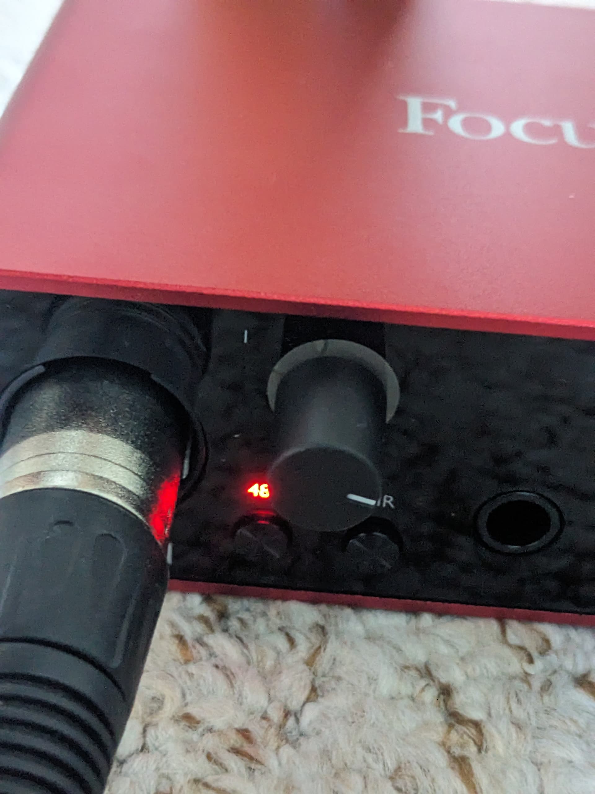

My sound level when speaking is between -12 and -6 with gain set as per photo attached - around 25 past if it was a clock face
We used to recommend that, but posters started finding mains-powered hubs with such crappy power supplies that the noise problem actually got worse.

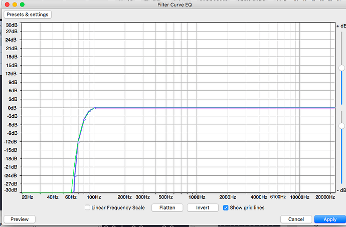

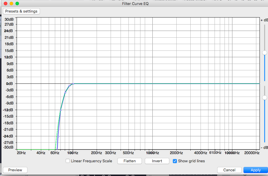

We did keep it around. This was a thing that Steve whipped up as a “Formal” 100Hz high pass filter. It’s a cousin to the noise filters used in field broadcasting.
Select the work.

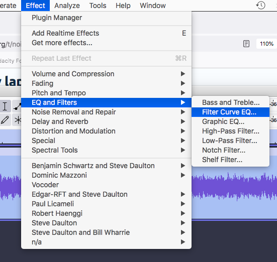

Effect > Eq and filters > Filter Curve EQ…

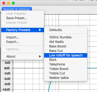

Presets and settings > Factory Presets > Low rolloff for Speech.
Apply

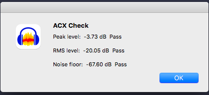

It suppresses rumble and guarantees peak sound and RMS (Loudness). If you recorded in a quiet, echo-free room, you may be done.
I recorded a voice test on an iPhone in my quiet office.
I mastered it and it passes ACX Audiobook standards. Being obsessive, I also applied gentle 6, 6, 6 noise reduction.
Our line is if you can pass ACX Audiobook standards, you can submit anywhere else.
