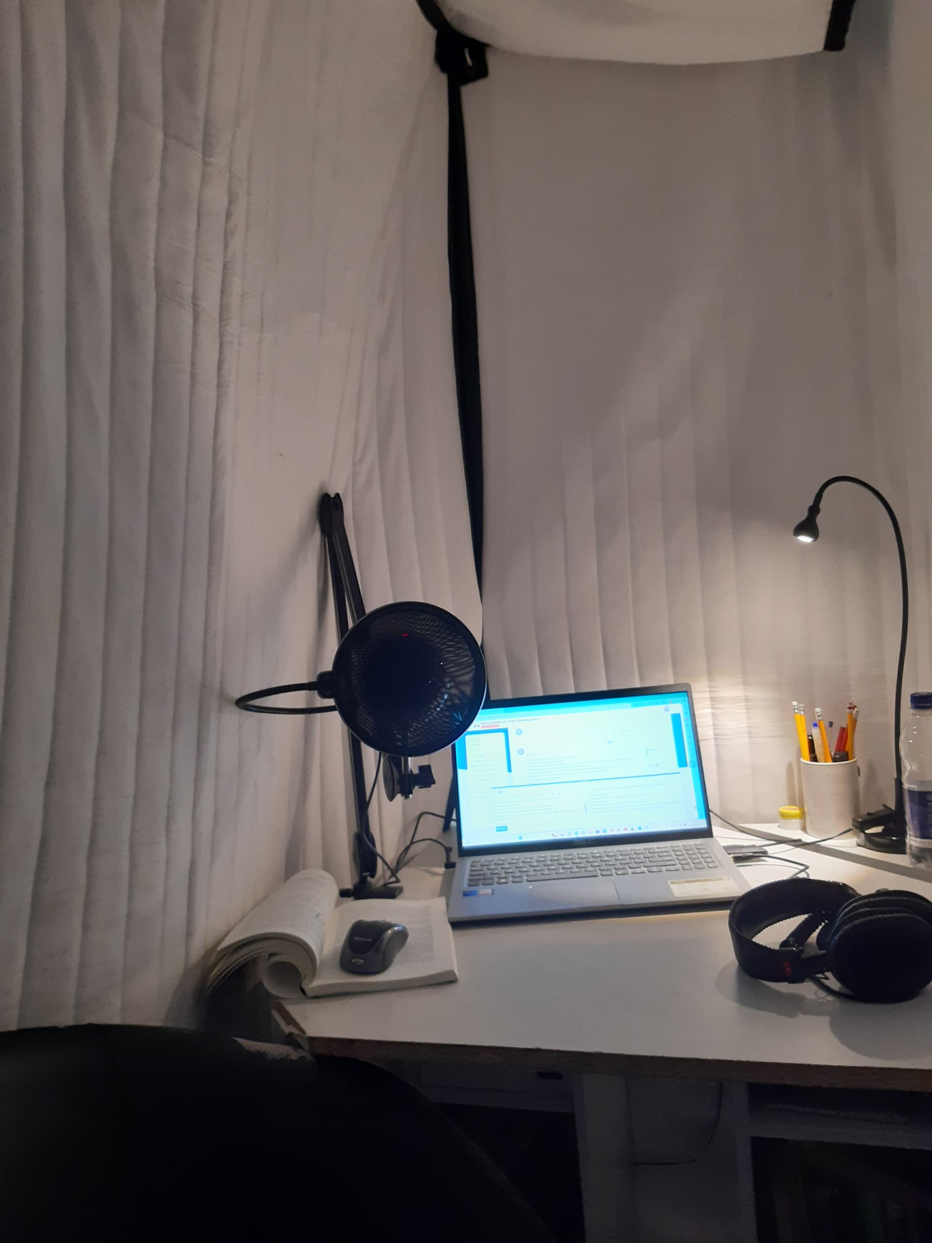

Also, the laptop was on a metal stand to raise it so I could see it over the script without moving and making extra noise, and I got rid of the stand for same reason.
So… could it be the boom?
Also, there is foil backed insulation in the back wall.

I think we’ve cracked it… I think this sounds A LOT better… with microphone/boom/cable moved away from the back wall (with power socket/metal-backed insulation)

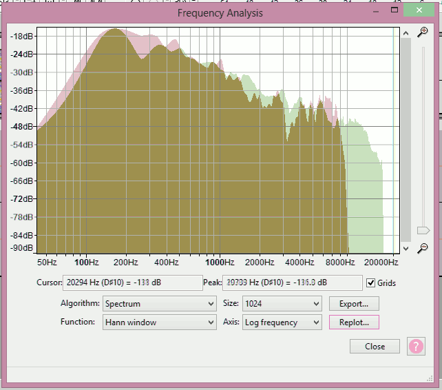

Here’s your spectrum (red) compared with an audiobook read by woman (green).
Plot Spectrum - Audacity Manual #
Your equalization is a good match as far as it goes, but it does not go far enough: there should be frequencies above 8000Hz.
The typical VOIP “audio enhancements” will discard the higher frequencies, they are not necessary to understand speech,
but for profe$$ional voice-over work you need to keep those frequencies.

So the mains hum is probably coming from the proximity of the microphone cables to the actual mains in the wall. If those mains are servicing other high-use customers such as air conditioners or the other residents of an apartment complex, I can believe that. The more heavy work the mains are doing, the more they’re likely to radiate trash to the immediate environment.
Again, I’m not making that up. Rock Band people in a live performance have to keep their sensitive microphone cables away from the powerful lighting cables.

If the “audio enhancement” is chopping-off everything above 8kHz before it gets to Audacity, then there’s nothing to work with above 8kHz.
An EQ change in Audacity cannot resurrect those frequencies if they have been removed.
