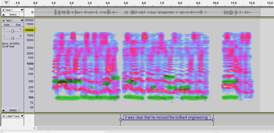

Test 1 & Test 2 have nothing over 9kHz.
For an audiobook the frequency should extend further up, say ~14kHz.
Test 1 has conspicuous mains-hum which does not occur when you are not speaking, i.e. there is a noise-gate operating.
Green horizontal lines are mains-hum, (& nothing above 9000Hz).
These are both evidence that “audio enhancements” are being applied.

BTW Your Test2 does not have any mains-hum,
(but it has been processed: noise-reduction & noise-gate).
