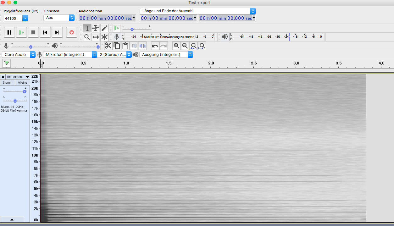

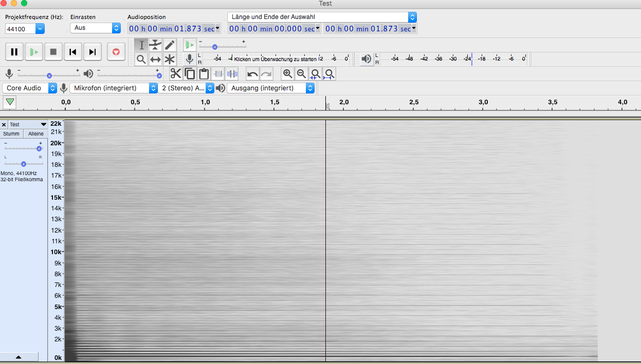

The already present noise is not louder, as can be seen in the spectrograms attached (for the settings see my earlier posting). Audacity is, at least in this case, not replacing audible quantization noise by less audible dither noise, but simply adding noise (which may, I admit, in many cases not disturb). All I suggest is that dither should not be applied when it doesn’t serve any purpose.

If you compare the two spectrograms you can see that there is much more high pitched noise in Test-export.aif at the end, and at the beginning the spectrum seems to be altered slightly (although I find it difficult to see). Again: I think the spectrum and the sound should not change at all when only simple editing is involved.
