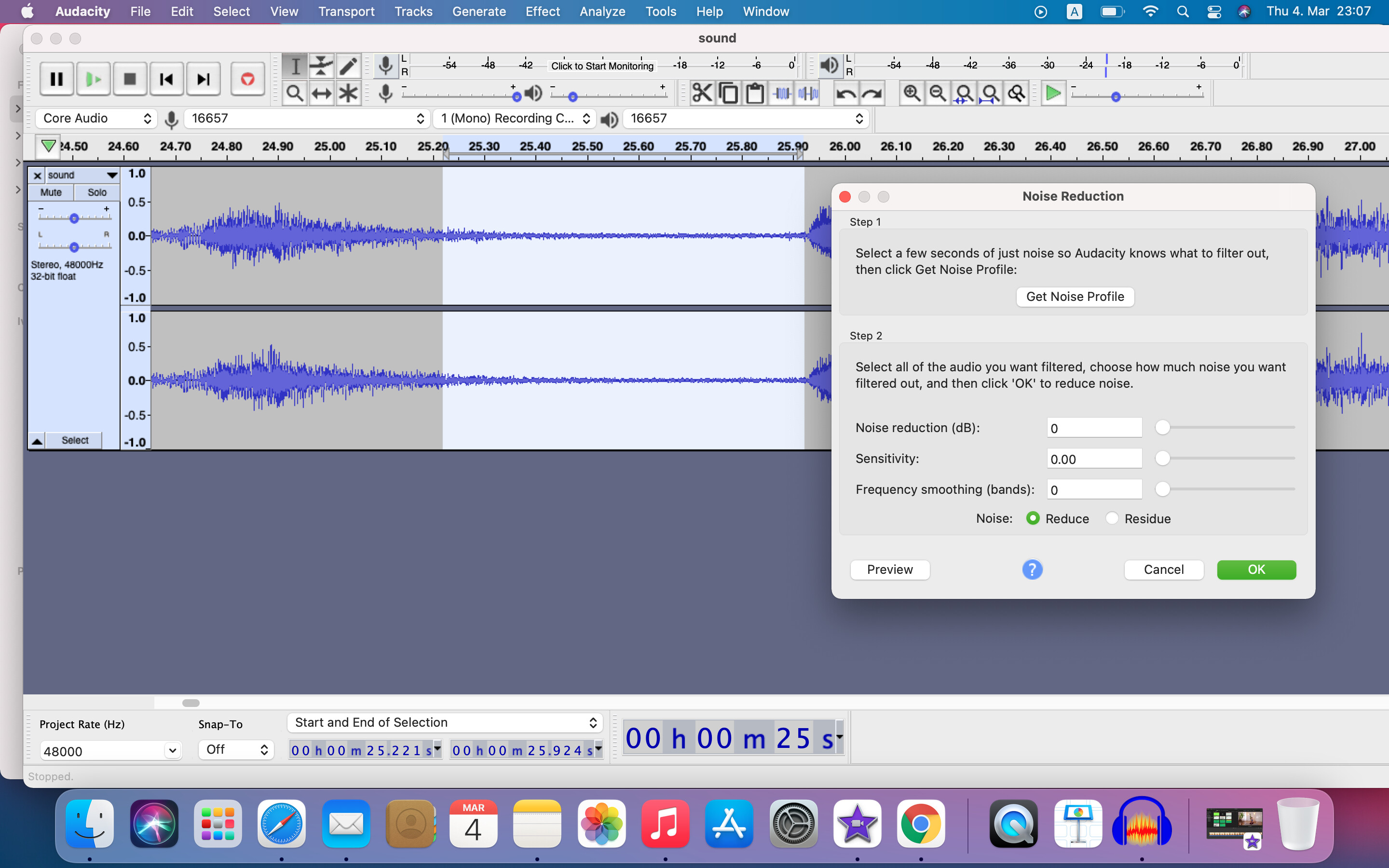

Look for a simple, clean echo in the dialog. I chose 7.65 seconds to 8.25 seconds. Ideally, the performer would clap once just before speaking. You may have seen some musical performers do that. They’re doing it for sound sync, but that’s not the only thing it’s handy for.
Effect > Noise Reduction > Profile.
Then select the whole file and Effect > Noise Reduction: 15, 6, 6 > OK.
It won’t get rid of the echoes, but it will suppress the “thick, full, fuzzy, cottony” sound. It will also get rid of a bunch of the background hisss.
