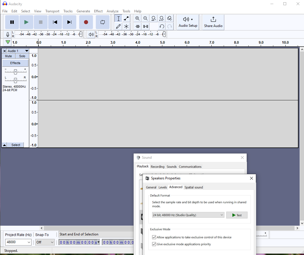

I know the foucus right works cause I have it all set up in abelton fine. Was trying to sample my computer audio and cannot seem to get it to work with any setting or combo I try.
I have the rates and bits set to what my 2i2 says
