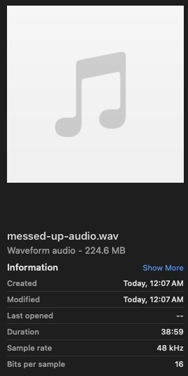

The wav was not that large. It is only 39 minutes though (just like the project file and the mp3).
I don’t know what rate the wav exported at. When I mentioned 192kHz I was referring to the project rate in Audacity.
