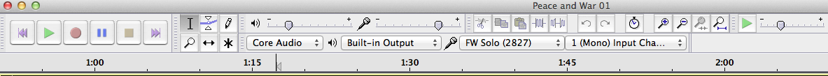

I am using an imac with mountain lion OS v10.8.5 and am using Audacity v2.0.5.i have imported a pre-recorded music bed and want to record a voiceover track using an m-audio firewire solo recording interface. for what its worth, the mic is a shure sm 58. in audacity my input is set to the FW Solo and the mono input channel. i have no level whatsoever. i do get a level when it is set to the computer’s built in mic. i have already verified that i am getting a good level from the external mic in system preferences - so that is not the problem.
i have searched this forum, tutorials and the manual for some real basic trouble shooting info but nothing addresses the specific problem of not getting any input at all. it seems it must be something very simple but i can’t tell what that might be. also, everything works just fine in garage band with the m audio set up. just not audacity.

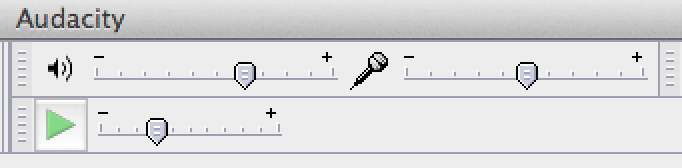

was having that problem too! I hoped you got an answer so I could as well but since you didn’t, I’ll tell you what I figured out. My input levels in the top setting bar were turned all the way down (no idea why).
This is what I changed - look at the microphone image on your app to see if it looks like this.
my input level is up.
I assume you are putting the Shure in the Microphone input #1.

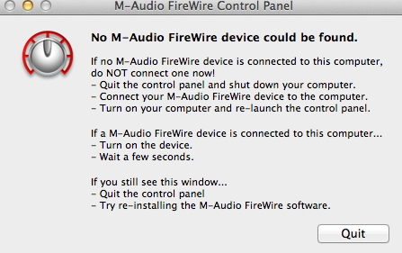

thanks for the help. it is getting to be too much of a hassle. i’m not much of a techie when it comes to computers - audio equipment and signal flow is one thing, once the system is integrated into a computer my head explodes. as long as my m-audio works in garage band i guess i am stuck with that on my imac. i only get a single channel using the 4 channel option with audacity. i checked the m-audio community forum and learned that m-audio is under new ownership and the firewire solo is no longer being supported - they have no intention of ever updating the drivers for that model. too bad the hardware works fine. its just strange to me that even when i click on system preferences and open the m-audio control panel it says my mac doesn’t even recognize it is connnected - yet it still works in garage band.
