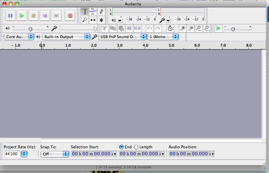

If I set Audacity to “Built-in Microphone,” I have the option of setting Audacity to Mono or Stereo, but if I set it to “USB PnP Device” the only option presented in Audacity is Mono.
That would suggest the Plug and Play device is supplying mono.

Thanks for getting back to me. I have Audacity 2.0.6 loaded on a Mac running OSX 10.6.8.
Audacity shows the cassette deck USB as a mono device. See below:

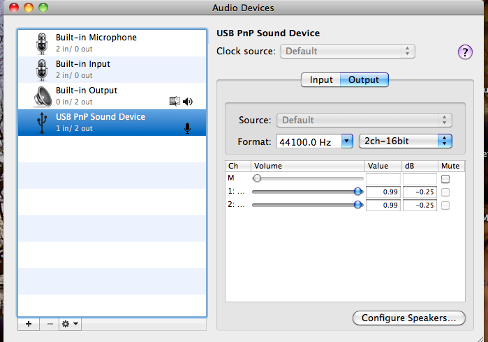

Also, my Mac is also picking up the deck as a mono device. See below:
You will see the device shown above as “1 in two out.” According to the previous posts in the Audacity help forum, “1 in 2 out” is mono, stereo would show as “2 in 2 out.” Do you have any thoughts on this?

The only input that is completely suitable is stereo line-in. I would guess your “Built-in input” showing in Audio MIDI Setup is stereo line-in.
Also in Audio MIDI Setup, PnP device selected, if you click the Input tab, are there any options to right of the “Hz” box to change to 2-ch?
It does have the >o< symbol. The Mac is a MacBookPro5,1. I have an RCA to 1/8 inch cable. I suppose I can go from the RCA line out to the 1/8 stereo line-in. I would be curious to hear what the previous poster, djames, had done.
