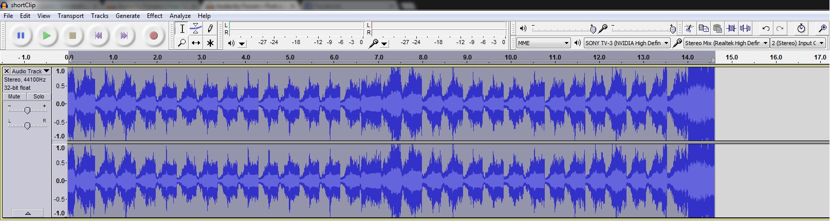

I’m attaching the sound wave from a 15 second recording of streaming audio that I know has a bunch of bass. When played through my sound bar the streaming audio has a lot of bass. I then replay it from audacity and it has nothing from the sub-woofer and very little trying to come from the bar.
I then did the vocal removal and the whole song didn’t disappear. The other attachment is what the waves look like after vocal removal. The result was a lot of high pitch music lol.
I still think it has to be a recording settings issue if the same streaming audio played over the sound bar sounds perfect and that exact same streaming audio is just recorded and then played the same way with a different result. Let me know what you guys think of these results and what I have uploaded. Thanks!

Cool. “Sandstorm,” anyone (attached)?
Clearly everything from about 400Hz down got suppressed. I need to go back and read through that again.
