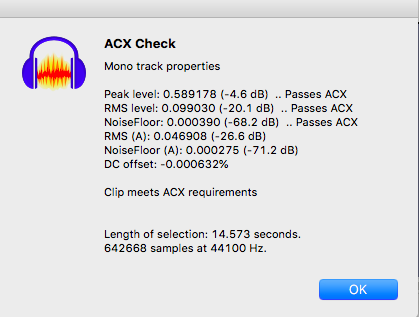

I won’t be able to listen critically for an hour or two, but as far as I can tell, that should be good to go.
All I did to it was apply the tools in Audiobook Mastering.
You can skip down to PROCESS. Those are the three tools plus ACX Check to test your work.
You do have to download and install ACX Check and RMS Normalize. Those two are not included in the current Audacity. The instructions are in that web page.
One note. I did cut off everything after about 14-1/2 seconds. It’s not good to leave too much silence in the tests. The two seconds of room tone at the beginning is enough for ACX Check to chew on. If you put too much silence in the piece, it can throw off RMS.
Root Mean Square is a sort of average and it depends on normal conversation and spaces to work out right.

The first step is a rumble filter. It doesn’t matter what the volume is for that. Most sound lower pitch than about 100Hz is useless (or outright evil) and is discarded. This is a rough copy of the filter Hollywood uses for outside sound shoots.
The next step is RMS Normalize which sets the loudness (RMS) of your show properly no matter where you started from. That’s the magic custom tool.
Follow that with Limiter to catch the occasional loud peaks. Those are the three steps.
If you started with a very quiet, echo-free room, you may be done.

Hi Koz…Well I have used equalizer,then RMS Normalize then Limiter and presto,no noise reduction necessary to pass the ACX test…Sent the file off to be assesed and waiting with baited breath…
