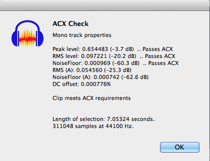

Now run Audacity and record some voice. The blue waves should look about the same size as the ones on my attachment.
Record a test…
Master it with the mastering tools and see if it passes ACX-Check. Post the numbers.
This is what happens when I just jam everything together for a quick test. The noise still isn’t quiet enough (it juuuust passes), but, again, I didn’t take any care at all when I made the test recording. I was holding everything up with my hands and my elbows on the desk.
That and I didn’t use any Noise Reduction, either.
