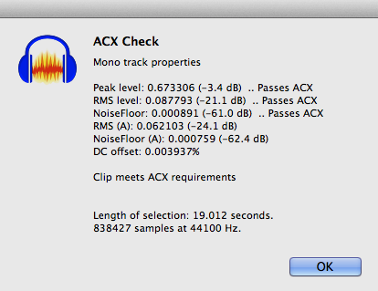

I got your test to pass technical requirements-barely.
Note the noise, after very stiff noise reduction, is -61dB and the requirement is -60dB. That’s not a lot. Your voice is just starting to sound a little hollow and further corrections will make you sound like a cellphone and are not recommended.
One easy way around this is either talk louder or get closer to the microphone. The noise measurement is the difference between your voice and the background. Make your voice louder and poof, the problem goes away.

I used Mastering according to this formula…
Scan down to PROCESS for the actual tools.
…and normal Audacity noise reduction at 12, 6, 6. Yes, that is high. Normal, gentle noise reduction is more like 6, 6, 6.

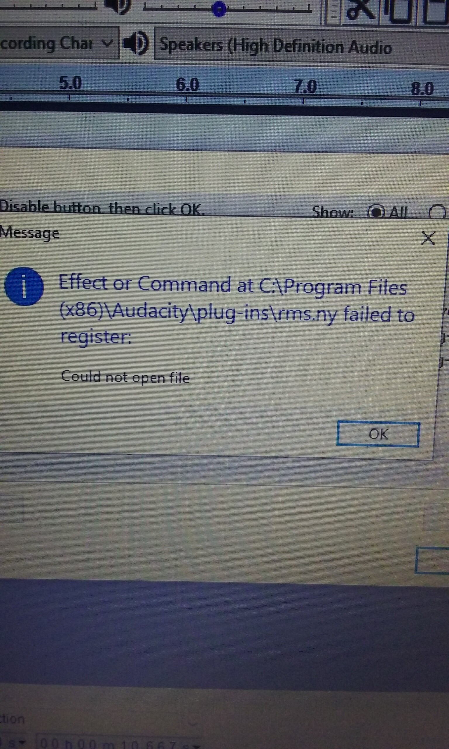

I have a pop filter in place and and in the recommended distance from my Mike… Nyquist is REALLY frustrating because obviously I need those plug ins but my computer is 64 bit, would that make a difference?. I import into Audacity but the file cannot be opened. I could you send you images of the box that pops up and maybe you could help…I shall try the new mike position that you recommended and try again then send you a new sample. I can download the plug ins but after that everything goes south and I really need a way through with installing these…

Here is a picture of the box that pops up when I try to import the ACX check into Audacity. Also is a audio sample with my mouth much closer to the microphone and with noise reduction set to 12.6,6.
Damn the box somehow went upside down in transit. Anyway here is what is says.
Audacity does not recognise this type of file c/user/owner/downloads/Acx,check.ny
Try installing FFmpeg for uncompressed files also try file, import, raw data.
I got as far as getting the plug in into my enable box under and this is what pops up

That’s not the correct filename. I have attached the RMS Normalize and ACX Check plugins.

Hi Koz…Thanks for the download links. Now please can you walk me through installing them into Audacity that is on a external hard drive on my windows 10 laptop. Please could you talk newbie language to a er newbie!
Thanks so much.
See this page in the Audacity Manual: https://manual.audacityteam.org/man/installing_effect_generator_and_analyzer_plug_ins_on_windows.html#nyquist_install

OK I am on the Nyquist download page that you sent me it says I have to place the file into. Users<Username<\AppDate\Roaming\audacity\plug-ins
Where do find that? Is that a process or a actual type site on my computer? I cannot find that above heading or how to access the above anywhere. Sorry to be such a pain.
Regards.Gary
Hey Koz… Just downloaded and successfully installed the RMS Normalize and ACX Check… Thanks to you …Sorry about the newbie ness on this thread but you have had the patience of a saint and have helped immeasurably… Wow…Going to thank you in the credits of the book when published…
