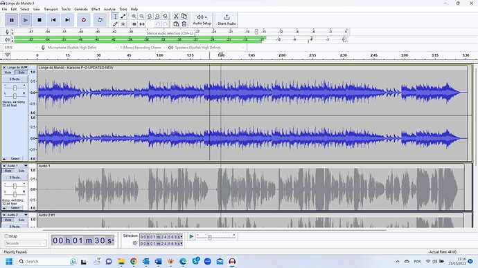

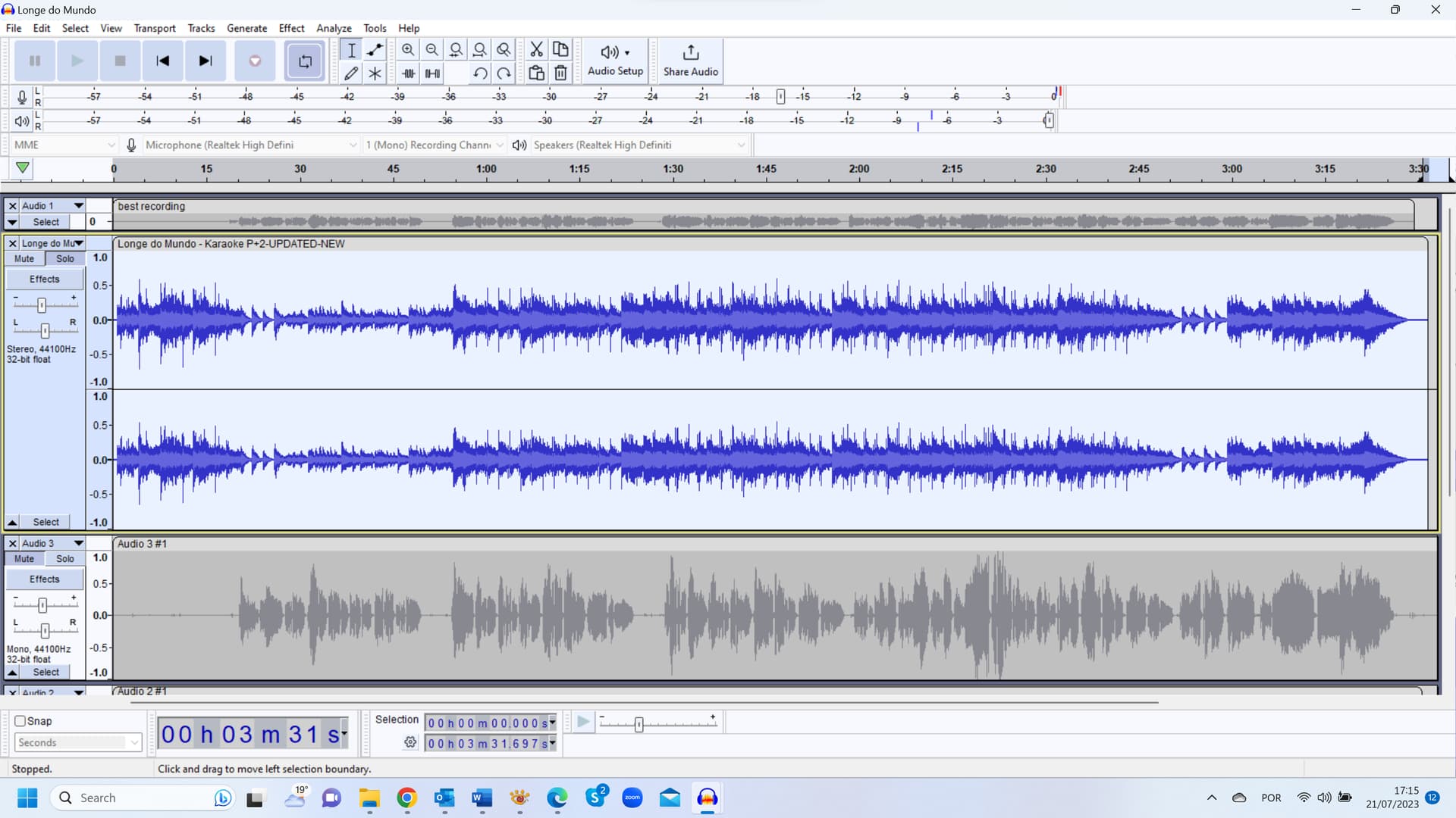

PS - Here comes the truncated track then, as I couldn’t add it to the other one. The cursor is more or less in the bit that is missing:
Here are the screenshots then, first the original track:
Oh, it seems that I can only send one of the backing tracks…
