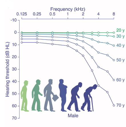

I can only just hear up to 13kHz now :older_man:,
so I rely on spectrogram displays , rather than judge by ear.
old geezers

I definitely identify more with the gentlemen toward the right side of the graph. :slight_smile:
