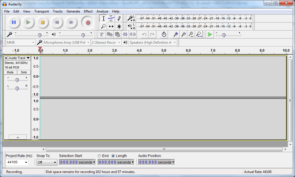

Here is a screenshot of when I am recording…the cassette is playing-as I can hear in headphones…but nothing on Audacity-no levels or sound…and it says recording at the bottom but the time counters at the bottom are unmoved and stay on 0.000
Your screenshot shows you’ve selected “Microphone Array USB” as your recording device. That might be OK, because Windows doesn’t always know what kind of USB device you have. But, are there any other USB choices? It also looks like it’s greyed-out, so maybe nothing is actually selected???
And, you might try Direct Sound instead of MME.
And, make sure to plug-in the USB before you start Audacity.

Device Toolbar always greys out when playing, recording or paused, even if the recording is stalled.
For the stall problem, restart the computer. Make sure the EZCap is connected to an empty USB port, not to a USB hub connected to the USB port.
