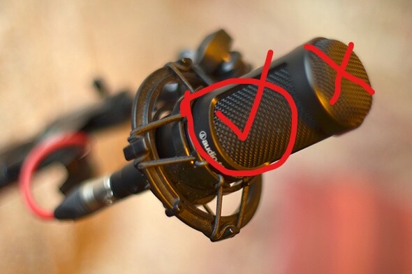

The AT2035 is a side-fire microphone. you talk into the company name, not the round end.

Okay for the AT2035 is this what you mean:
I spent a few minutes peppering the music store guy on the phone about the AT2035, he has been using one himself for a few years so it was very informative but I didn’t think to ask about that, thank you! Same for the interface, that is another thing I didn’t consider, mono vs. stereo. I’ve listened to audiobooks for years and forgotten they are definitely almost all mono. Seems to be the thing with all this is ya just gotta test and trial and error for quite a chunk of it!

Those things inside the round cage are rubber bands. If you gently thump the microphone, it will sloppy wiggle at you. Here’s another picture.
Make sure the cable is floppy loose. You can get noise that way, too.
