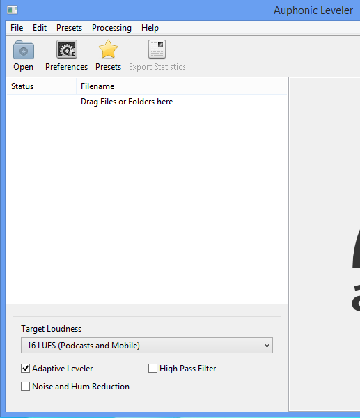

I have shown you via links to the EBU website where they do allow for different setting for the mobile players and Podcasting. Here again, their suggestions, not mine. Even the Auphonic website states this as well. Their program was designed to meet the EBU suggestions and they even have the terms “Mobil and Podcasting” built into their program, under their desired LUFS target.
It is also on the desk top version of their software, that they sell to the public. You can view the picture below, I have paid for their program so I could use it off line and I use it weekly. It is no different then the ACX Analyzer that comes with Audacity. They both are simple to use and both take the mathematics out of the equation.

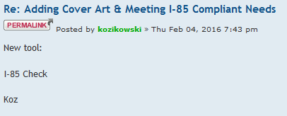

Even Koz suggested adding it as a new tool with Audacity. “New tool: I-85 Check
Koz” on the same page as mentioned above.
