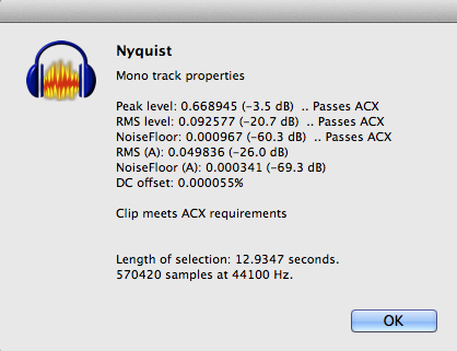

The requirements for AudioBooks, at least from ACX, are stiff. I would expect whatever you plug into the side of your computer to fail one of the three specifications. That connection is designed for Skype, Chat or other communications job. Not theatrical production.
We have tools designed to make AudioBook production easier. The premier tool is ACX-Check which mimics the Quality Control Robot at ACX. That’s the first test that your submission hits even before a human hears it.

This is a sister posting to yours from someone just coming down the home stretch for Audio Book Reading (don’t pay any attention to lines four, five, and six).
The first three numbers are critical. This is a thing I wrote a while back.
https://forum.audacityteam.org/t/measure-between-23db-and-18db-rms/32770/16

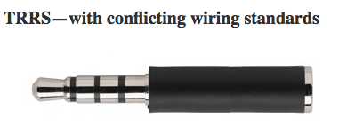

combo audio/mic jack
I also got an XLR to 3.5 cable to go from the power supply to the computer jack.
That first is from the Lenovo instructions. Tell us a lot more about the adapter cable. I expect the computer end to look something like the attached. As in the text, what the computer does with the connections can be different. You have to buy the cable specifically for your computer and the computer is not a current model.

The first adapter didn’t work because it’s a Tip, Ring, Sleeve (TRS) instead of a TRRS connection that is probably what’s inside your machine.
The USB adapter should probably work. It’s an aggressively stripped down version of the Solo.
