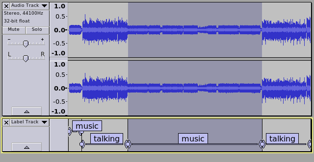

It’s quite easy to see which part of the recording is talking and which part is music - I have labelled this example:
To remove the music sections, just select a section that is music, then delete it.
You may find this tutorial useful: http://manual.audacityteam.org/o/man/tutorial_editing_an_existing_file.html
