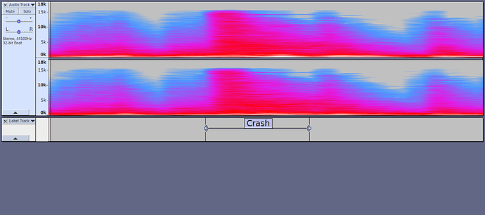

I doubt that is possible.
As you can see from the Spectrogram track view, the cymbal crash extends across virtually the entire frequency spectrum, so removing the cymbal crash will leave a very obvious “hole” in the audio.
Depending on the project requirements, perhaps you could just trim off the first 9 seconds or so.
Alternatively, you may be able to find a MIDI version of the music, then in a “MIDI sequencer” you could remove the cymbal crash notes.
Probably not. Audacity can’t split a mixed performance into individual instruments, voices or sounds.
The probablity goes down further if you’re trying to do the surgery with a compressed posting such as a YouTube piece.
You might be able to use Edit the Spectrogram tools. You should know that with a sound that prominent there isn’t a lot of background sound in there to fill the hole.
https://manual.audacityteam.org/man/spectrogram_view.html
Also, a sound that “crashy” contains a lot of different pitch tones and it will interfere with other musical tones during the edit.
A De-Esser can attenuate cymbals , but won’t remove them completely …
