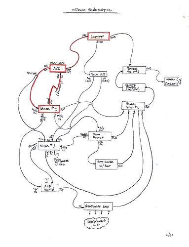

Attached is a schematic of my setup. It is quite involved/complicated. The only part I believe we would be interested in is highlighted in red (Laptop, UCA202 AI, & Mixer #2). I understand if this is confusing as I am not an audio engineer or anything even close (just a retired guy with not much else going on).
Again Mark, thank you for your interest.
Steve
Thanks Steve,
I really appreciate the diagram. The more I think about it, the more I think this is the Windows 8 equivalent of the common Windows 10 ‘mono’ issue described by Trebor in post #3. That’s because it is recording but not in stereo, if I understand right.

I have another mixer (Behringer 1002) that I can try. I just want to make sure I’m connecting this correctly (see diagram)?

Some further thoughts. On your last schematic with the 1002 mixer and the 202, I don’t get why you fed the output from the 202 back to the 1002. Surely your audio sources all go into the mixer, the mixer out goes to the interface’s input and the USB from the interface goes into your PC.
Harking back to the ‘simpler’ suggestion referred to before; if you have a hi-fi system with RCA Aux ouputs you could connect the 202 input to those and then the USB to your PC. Try digitising a cassette or LP and see if you get proper stereo using only the 202. Removing the RCA plugs in turn should make the affected channel flatline. That should at least prove the 202 is doing its job.
Mark B
The reason I’m sending the 202 OUT (or phones out) back to the 1002 is so I can monitor what’s happening. If I unplug the 202 OUT, I get nothing from the 1002 phones.
