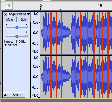

OK. Basics. Select View > Show Clipping.
See all those red marks? That’s all the places your sound got so loud, the microphone stopped accurately following the notes. That’s those crunchy, fuzzy tones. That’s overload or “clipping”.
That distortion is permanent.
So you have to record at a lower volume. Record so your blue wave tips go up to about half to 3/4. Not any higher. If you can see the bouncing sound meter, you can get loud so the meter just starts to turn yellow.

The badness is called clipping.
Audacity’s Clip fix removes the worst of it …
but better not to have the problem in the first place by allowing headroom when you record.

Having listened to your sample clip, by far the biggest problem there is, as Koz commented in his first reply, clipping.
Reduce the signal level a little to avoid clipping will instantly make a huge improvement to the sound quality.
