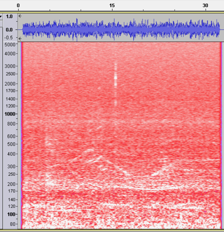

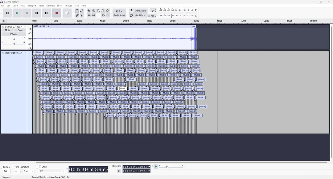

I can legitimately hear music with lyrics on this file EXTREMELY faintly in the background. However when I upload the file in audacity it is only transcribed as “music”. Could someone help me to confirm if this is correct, or if it is a program glitch/Auditory Pareidolia?

Try running it through music separation before transcribing
IMO neither music or voices. Motors ramping up/down, air-con, electric vehicles …
This is a known problem with OpenVino Whisper.
Because it is external code called by Audacity you can’t mess with the configuration to fix it. The most you can do is try another model.
