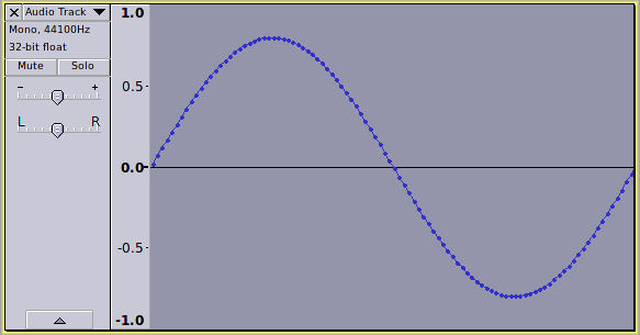

Which one is “blockier”?
Before “up-sampling”:
After up-sampling:
Well we can do that with images too:
There are many upscaling algorythms! Depends on the case, really, If I had to upsample a song with voices I’d use polynomial interpolation instead as It has less noise.
The difference between your graphic example and the audio processing is that the graphic up-sampling is reducing the appearance of “steps”, whereas the “Nearest Neighbour up-sampling” is increasing the appearance of steps.
Back to the audio sample:
Where the original sample rate is reasonably high (44.1 kHz or above), the “Nearest Neighbour up-sampling” does not do much harm as the distortion frequencies are all too high to hear.
If the original audio has a low sample rate, then “Nearest Neighbour up-sampling” will create audible distortion.
If audio up-sampling is done perfectly, the result should sound identical to the original.
