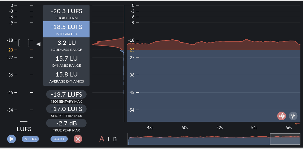

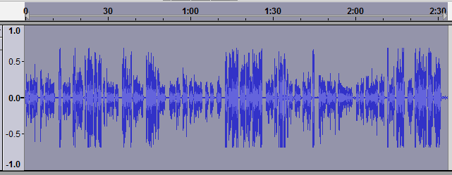

I am most concerned about how my theatrical narration sounds to the listener. There are fairly high elevations and low-downs between when I am playing a part, and when I am using my narrating voice. Does this provide a problem to listeners and make it generally uncomfortable to the ear, or is this style mostly fine? Any other ear-sores I should take to concideration?
This sort of theatrics come quite naturally to me and I find it hard to keep my voice steady when I am in character. Tips from other narrators are very welcome. I rather not use compression if it can be avoided.
Mic used: Deity VO-7U, Gain ~60% from max, distanse to mouth about ~18cm.
Recorded with: Audacity
Plugins used: Filter Curve EQ-Low rollof for speech, Loudness normalization, Peak limiter : all to ACX standard.
The clip passed ACX requirements as is.
