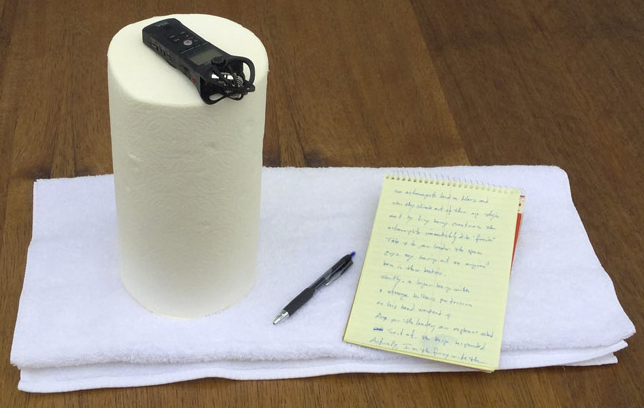

What’s the show and what are you recording? It’s not unusual to get the maximum stability and success by capturing on a sound recorder and not a computer. That’s a Zoom H1n sound recorder. It doesn’t have any “computer problems.”
