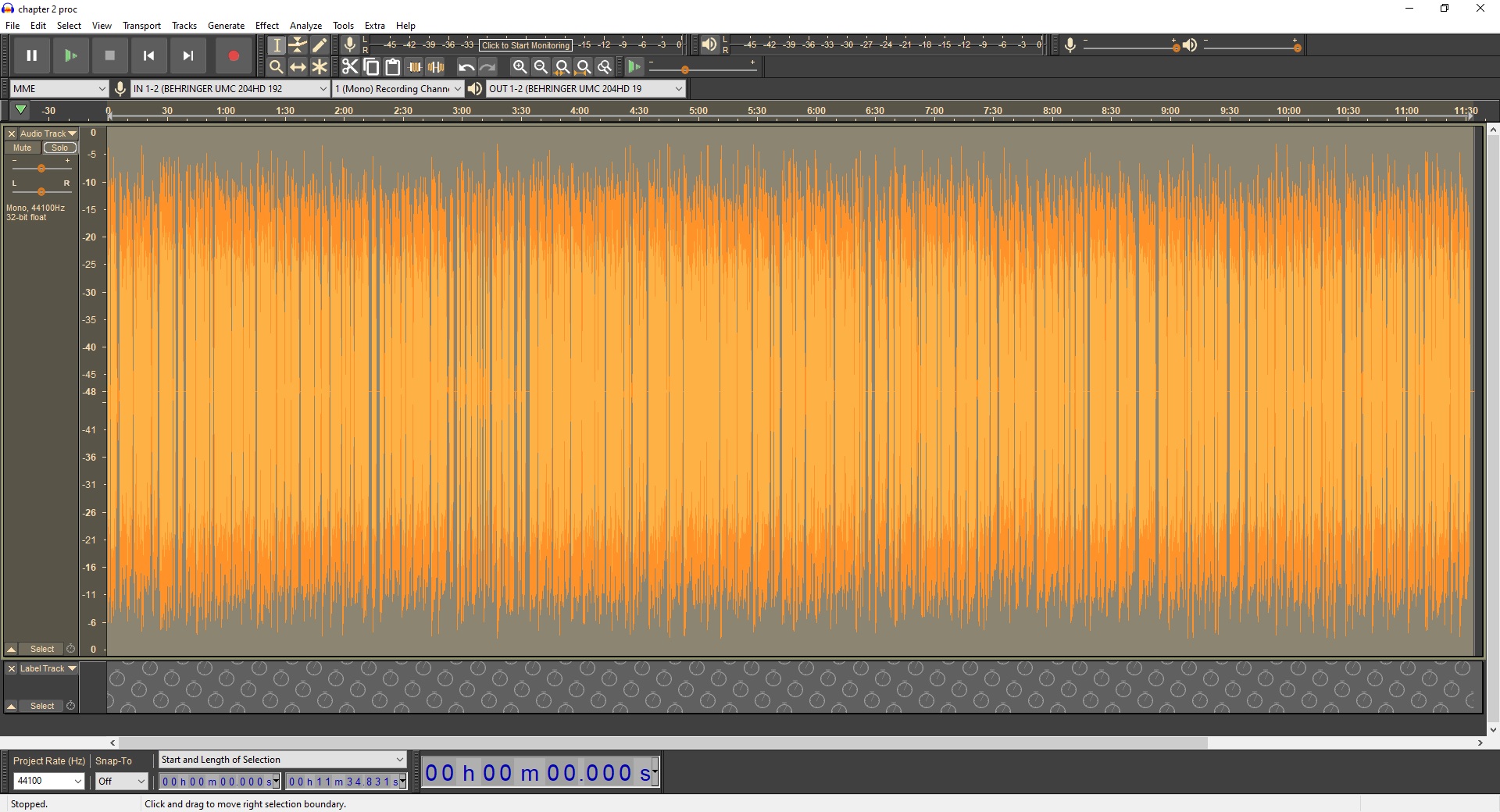

I just checked and it DOES look like it clips at -6 db on the input. My first thought is I could make a Y cable of 2 XLR males and 1 XLR female so I drive both inputs of my preamp. That probably wouldn’t work since it’s in single channel mono in audacity. I didn’t see anything in windows (I use a win 10 PC) or in audacity to change that. Have you?
I would never use that 0-1 vertical amplitude scale, I would ALWAYS change it to db.In my mind after years of seeing VU meters of all sorts calibrated in db it just makes more sense and lets you actually see more of the waveform during editing.
Of course always record at 32 bit floating point.
That -6db clip point is interesting, I just hadn’t noticed it before.
I’m sure you are aware of ity but others may not be, one other thing I like about the db scale instead of others in audacity is that it gives you an idea of what your RMS as well as peak level is. You can see the audio on this file pretty much fits acx spec. Especially in the dark profile it stands out well. I have seen some folks that edit in the spectrum screen and while I may try it, it looks so odd!

There is yet another variation. I have a Behringer UM2 single XLR interface. It clips at -3dB/70% whether I’m in stereo or mono. This is a “mono” interface, so not having the level shifting is understandable. It’s job is to mix your guitar and your microphone—not likely to ever add in volume. But I do wish it had simple, ordinary, full volume range…
I don’t like the timeline being in percent. I want it in dB, but not that dB.
It’s exactly the same waveform as before, but the labels changed to more match what the sound meter is doing.
Quick, what’s -3dB in percent?
[put down four, carry three, anti-log base-10 of the doobly-doo]
70%.
