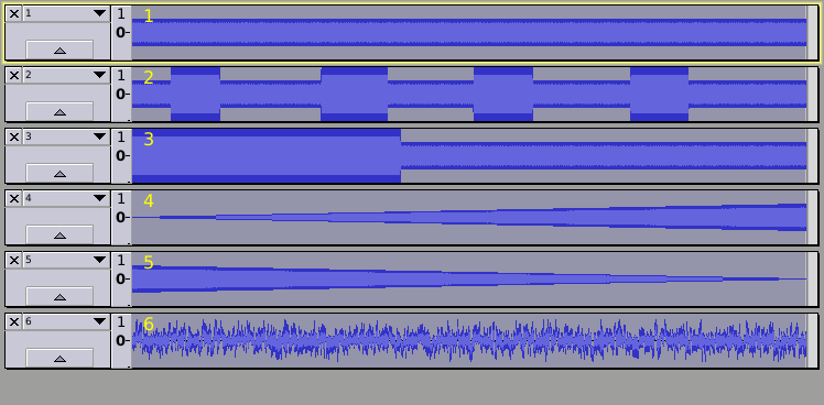

Audacity does not change the track order when exporting multi-channel FLAC. To verify that, create six tracks that are all visually different, export, then import the file back into Audacity.
Perhaps your sound device maps the channels differently when it is playing a disc than when it is playing a file.

Yes, on Windows 7 (and Steve is on Linux). Did you try it? I see no reason this should depend on platform, though.
