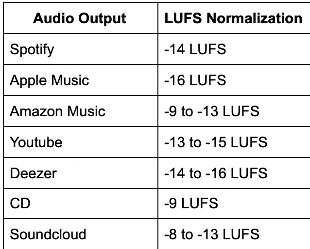

The latest version of Audacity has “loudness normalization” which is better for volume consistency from track to track if you select LUFS …

(1) Alternatively, you can check the LUFS loudness with Youlean online loudness meter..
Commercial CDs are done by-ear and sometimes there are intentionally-louder and intentionally-quieter tracks.
Although Audacity can set the LUFS level with Loudness Normalization it doesn’t have a built-in way to simply check and report the the current LUFS loudness.
