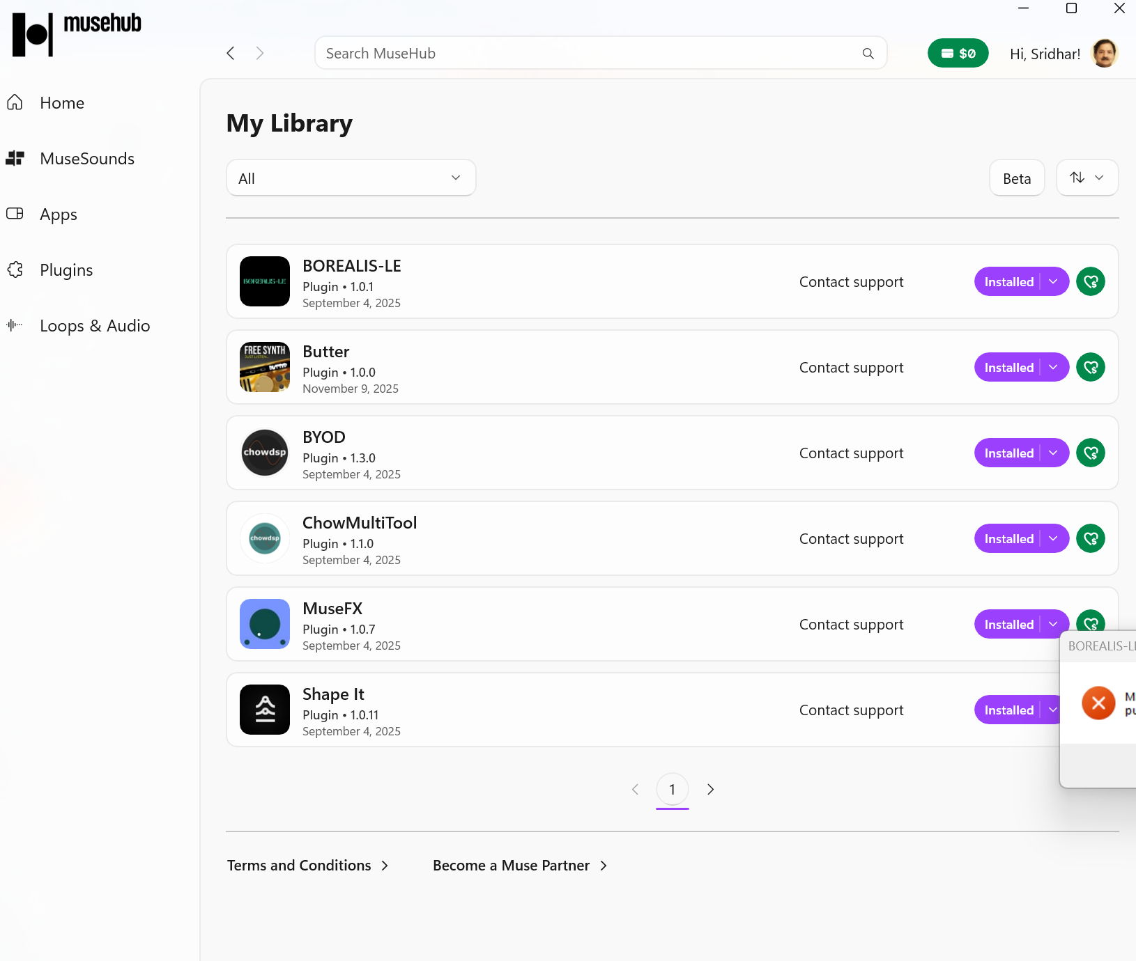

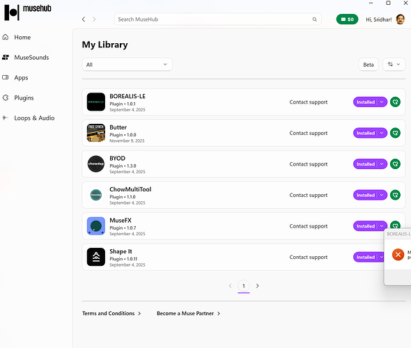

you can see the screen shot of my Muse HUB app. All the plugins seem to be proper order.
