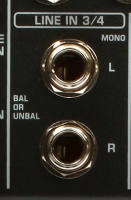

Oh, wait. I’m falling asleep. Did you plug your guitar directly into the mixer? Both Left and Right (attached-1)? If you only used a single plug, the guitar is only going to appear on one or the other.

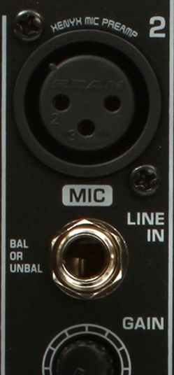

You can try to plug your guitar into Mixer channel 2 (attach-2). That should be fadable between left and right with one single plug.
I don’t have the correct cable for attach. 2, but when I plug it into the normal input, the problem isn’t solved. I tried putting the mic in the regular jack-input together with the guitar in the jack-input in 2, but also than the problem keeps appearing

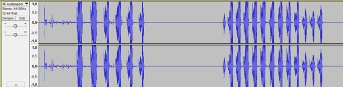

I have the xlr of the mic plugged in channel 1. When the pan knob is all the way to the left, audacity records like this (attach. 1). As you can see, there are silent parts in the recording, this happens when I turn the knob to the right.
Is channel 1 supposed to be a stereo input? If so the pan knob isn’t working according to your image. Audacity is just duplicating one channel to the other, which I would expect from a mono input.
Then apparently you can’t pan it in the Behringer. Does it record without dropouts if pan is centred in Behringer? Does centering and adjusting Balance help?
