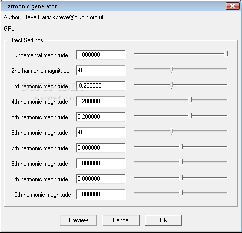

Adding harmonics (higher frequency versions) of what sound there is on the recording.
If you are on Windows there is a free plugin for Audacity which adds harmonics …
http://www.softpedia.com/get/Multimedia/Audio/Audio-Plugins/Harmonic-Generator.shtml
After adding harmonics remove all frequencies below 200Hz using the equaliser.
However I think you are flogging a dead horse try to salvage something from this recording.
