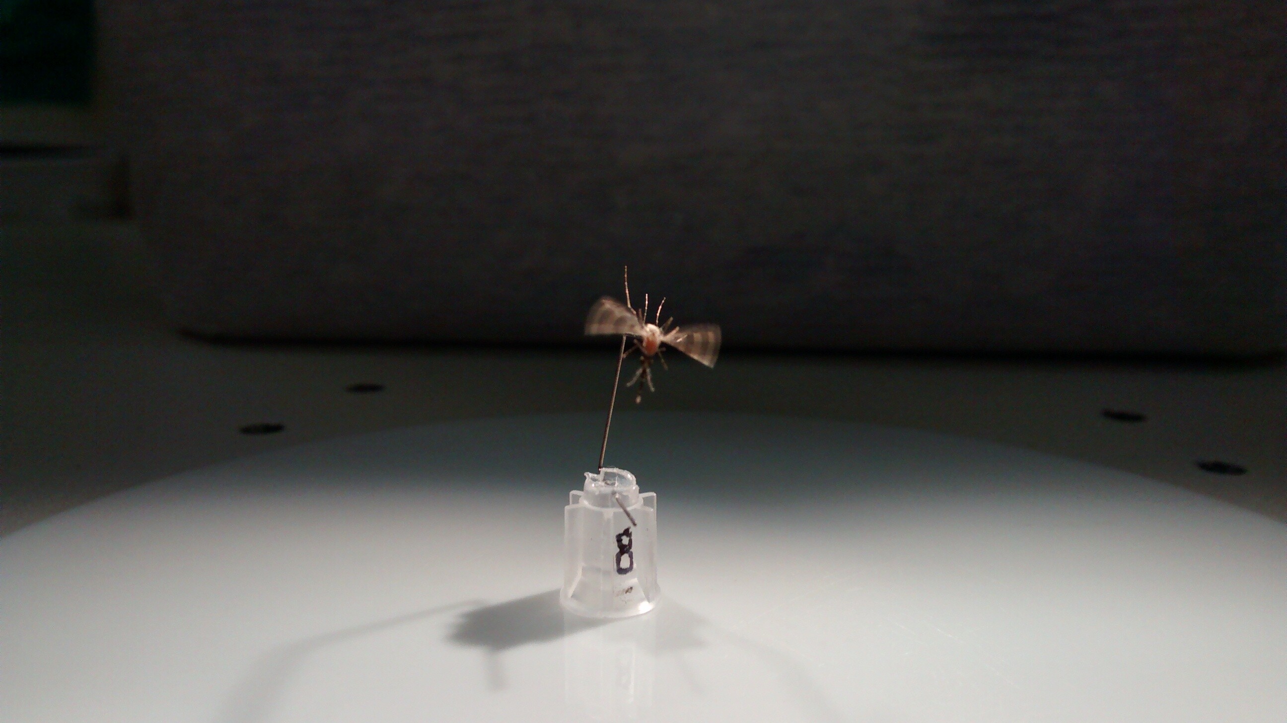

We are studying African malaria mosquitoes’ flight behavior. We tether them inside a flight tube and record their flight for 10 hours using voice recorders (44100 or 8000 Hz, mono).
This results with large files which we need to extract the amount of flight from (the mosquitoes only fly for short periods of time, if any). Mosquito flight sound is generally between 500-2000 Hz.

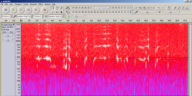

You could remove frequencies outside of the range of interest using the Equalization effect. You would need settings similar to this:
After filtering, there ‘may’ be enough amplitude difference between flying/not flying to be able to use “Sound Finder” (http://manual.audacityteam.org/o/man/silence_finder_and_sound_finder.html#sound), or simply to be able to see the flying sounds by looking at the waveform (zoom as appropriate: http://manual.audacityteam.org/o/man/zooming.html)
If you do use Sound Finder, I would suggest that you don’t run it on more than about an hour at a time. Nyquist plug-ins (Sound Finder is a Nyquist Plug-in) often have trouble with very long selections.

I have no difficulty in ‘seeing’ flight, I want to have it automatically extracted from the 10 hr file.
It’s actually more complicated since the flight sound varies in frequency as well, so I kind of answered my self here…
“Sound Finder” creates “labels” (http://manual.audacityteam.org/o/man/label_tracks.html) which may be exported as a text file.
The fundamental-frequency of some mosquitoes goes as low as 350Hz …
Again if there is enough amplitude difference between flight/non-flight you “may” be able to use Truncate Silence to remove the non-flight sections and so make a track that only contains flight sounds.
Again if the flight sounds are loud enough, you could try Sound Activated Recording.

The Sound finder does a pretty good job at detecting the flight and can be suitably adjusted for it.
Now how did you say I could extract the (label) data again?

If so, you can use the region labels created by Sound Finder to export multiple, giving you one audio file for each labelled region.
The labels do not contain text data about the sample amplitude values. Is that what you want in the CSV file? If so, see Analyze > Sample Data Export….

My goal is to learn how much flight took place in the 10 h trial/track, and when.
So I would like to be able to extract the flight periods from the background so I (A) can sum up the total duration, and (B) find out when the flight took place within the track.
Right now I am able to extract most of the flight but when I truncate the ‘silence’ (=background) I am left with a chunk of flight which only gives me the total flight, but not the times it occurred on.

A “Bandpass” filter would leave behind only the frequencies specified.
MP3 is lossy, so only use it if you need very small files and only for a final, finished file.
Sound Finder made region labels where the flight occurred. You can use File > Export Labels… which gives you a single text file listing the start and end point of each label (in seconds from the start of the track).
