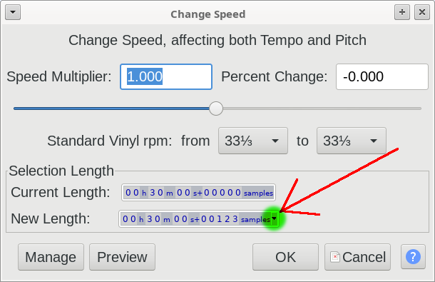

If you click on the little black arrow on the right hand end of the “New length” time control, you can set the time format to “samples” or
“h : m : s + samples”. That will allow you to specify sample accurate times.
How haven’t i noticed that in years when it’s that obvious?.. Thank you so much!
