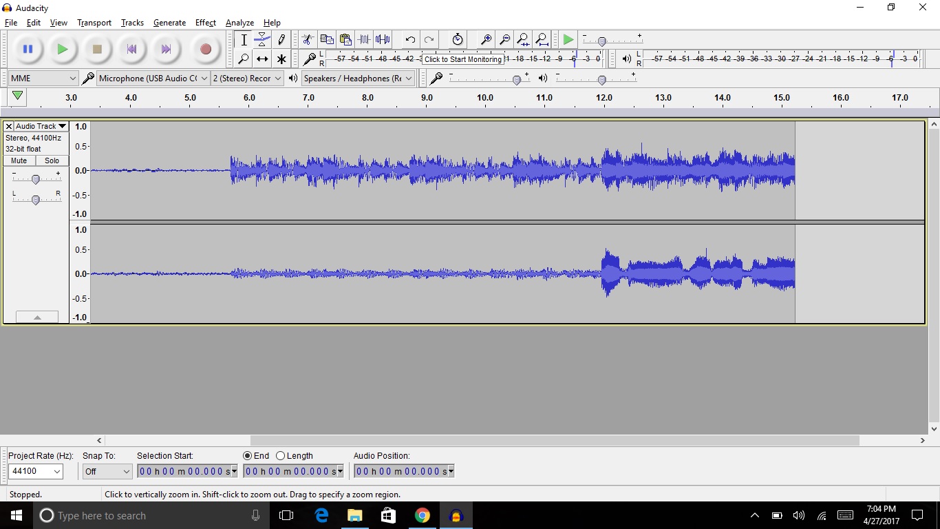

THAT FIXED IT!!! Thank you so much! I’m not surprised it was something so simple that I missed. Like I said, total novice. Thanks again.
I had the same problem. On the second try I decided to simplify everything. First set the LP120 source codec to 44.1 kHz 2-channel (in first try I picked the 48 kHz. Then by Audacity I set also to 44.1 kHz 2-channel. Now here is the kicker: I changed the bit depth on Audacity from the default 32 bit to 16 bit PCM. Note that the LP120 is sending a 16-bit stream and there is no option for a greater bit depth. So I reasoned that if all my gain settings were at 100% that there would be no rescaling of the data and no loss of dynamic range. End result: Now I have the two channels being clearly independent whereas before they were not!
