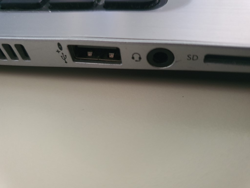

There are 2 kinds of 3.5mm connections. Most newer laptops have a single mic-headphone combo jack and these need a 4-contact TRRS plug to make the microphone connection. If you have a mis-match you’ll need an adapter. (The headphone connections are interchangeable and don’t need an adapter.)
That’s my question. Does yours have that? Dig in your machine instructions.

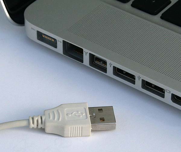

If not, you will have to use an adapter or preamplifier and digital adapter. Also, again depending on your machine, you may not have legacy USB connections.

Ok so first things first. I got an HP Laptop 430G3 and an old Chuwi Hi8 Pro Tablet
My laptop shows a sign for both mic and headphone on the 3.5mm so i guess it supports it.
It seems like you’ve confirmed the mic is working but it should have a connector like [u]this[/u] with the extra microphone contact.

Since its working why should have to buy a separete adapter and have the mic plugged in there?
Your mic has the correct connector so you don’t need an adapter.
