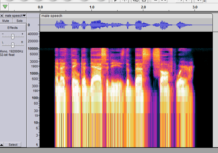

You’re going to need an unusually high sample-rate of at least twice that frequency.
and that code (full AM modulation) will generate a redundant inverted version, which is a waste of bandwidth.
192Khz sample rate
