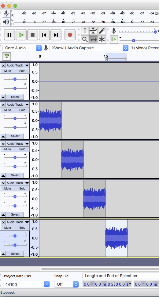

You’re trying to jam everything onto one timeline, right?
It’s not the worst idea to spread the segments out vertically like this.
Those are graphic examples, but unless you stop it, that will play as one continuous show, left to right, automatically jumping from track to track.
You can use the Time Shift Tool (two horizontal black arrows) to shove things around sooner and later, and you can apply effects and filters to each segment as needed without interference. Audacity will smoosh everything into one single show when you export, or you can do it ahead of time with the track management tools.
