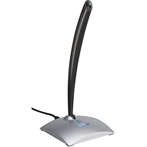

For basic voice recording, reasonable results can often be achieved with an inexpensive (around $20 US) USB desktop microphone.
One Audacity user posted a very reasonable recording using one of these:
The advantage of a USB microphone is that it bypasses the on-board sound card, (which in most PCs are pretty low quality).
If you eventually want to do more advanced recording then you will probably need something better, but something like this should be good enough to get started.
When using a USB microphone, plug in the mic and wait for Windows to detect and “install” it, then open Audacity, Check in the device toolbar that the recording input is set to the USB mic.
If you find that you lose audio playback when the USB mic is connected (very common) the solution is here: http://manual.audacityteam.org/o/man/faq_playback.html#usb

That would be me.
http://kozco.com/tech/audacity/pix/USBMicrophoneMacBookPro2Final.jpg
I own one of these and I like it very much. You would be hard pressed to beat it for sound quality, room echo rejection and simplicity. It may not be for sale any more. I haven’t seen it in a while. — Mostly eBay and some Amazon.
