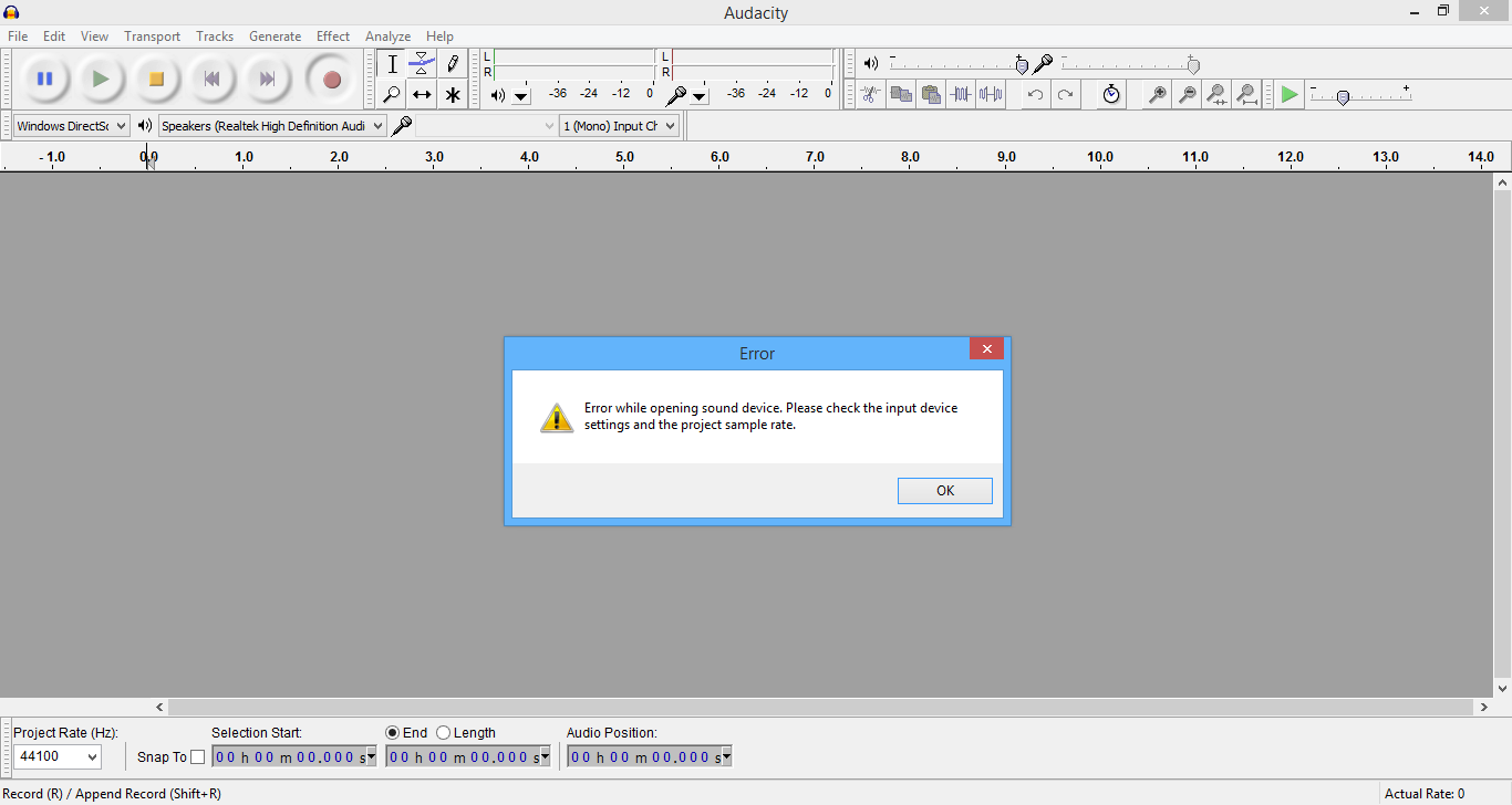

I can’t record anything, the Mic has nothing to do with the problem. Every time I hit record, I get this error:

You get “error opening” because you have no input devices in Device Toolbar .
You cannot record with your mic if Windows does not see it.
If it is a USB mic, try following “Detecting USB and Firewire devices” here: Audacity Manual . Be sure to try another USB cable.
