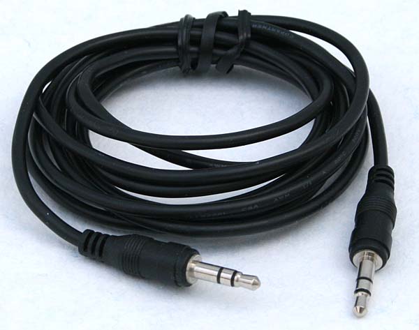

What does the plug on the microphone cable look like?
Is it a ring-tip-sleeve like this? Two black bands?
There are two ways to connect a microphone. The computer method has two black bands, but my Olympus recorders take a microphone with only Tip and Sleeve, one black band. You can’t easily cross them.
Ooop. I see the microphone has a battery compartment in the cable. You did put the battery in, right? It takes an LR44. I generally use a Silver 357 for better performance.
You also have to turn it on.
