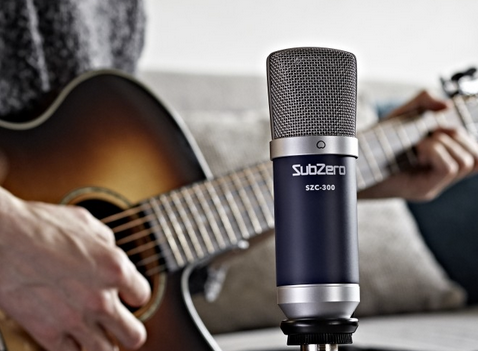

I don’t know where it says this, but the “front” is the side grill just up from the company name. It’s a directional microphone, so you have to get that right. It won’t sound right speaking into the top or the back. Don’t talk into the serial number.
Screen Shot 2024-01-16 at 1.09.56 PM
I’m betting the promotional graphics were not passed by an engineer. That guitarist is playing into the back of the microphone.
Nobody will be shocked by this. The famous Blue Yeti microphone went on sale with the usage instructions correct, but buried in the back of the manual. I knew they were there and I had trouble finding them. The microphone became popular with half the internet using it wrong.
