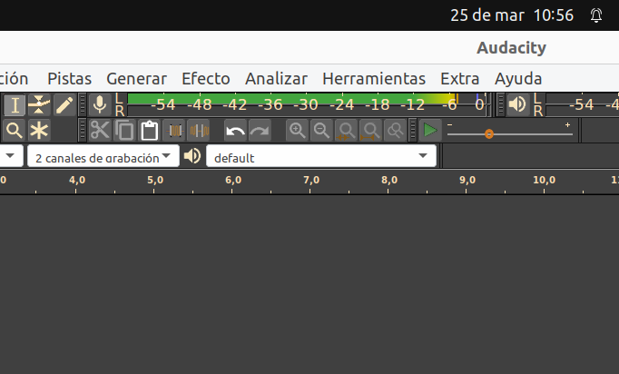

Captura desde 2024-03-25 10-50-50
As you can see in stereo it doesn’t happen, there is no forced limiter.
