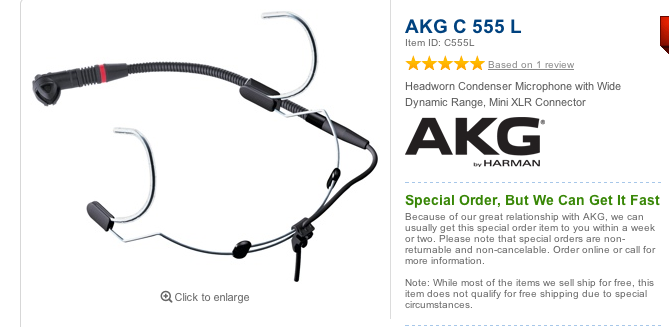

That thing on the left is an AKG C555L.
http://www.sweetwater.com/store/detail/C555L
It’s an XLR microphone whose claim to fame is to make the room vanish. It does take a 9 volt battery and the instructions claim it will run from 48v Phantom Power, although I’ve never used it that way.
Nobody will accuse this thing of perfect studio quality, but it does very well and I was able to host a lecture while standing in front of the stage speakers with no feedback. That’s very difficult to do. My illustration shows the little foam muff over the microphone head. When you first fit the headset, you need to remove the foam to make sure the microphone is pointed toward your lips. After that you can replace it and go.
This is the next step after the shotgun fails. There is a moisture barrier built-in to the head, but if you don’t need the strict close-talking feature, you may not have problems with that.

This sounds really good actually? Can the AKG C555L be mounted on a mic stand?
Sure. You just can’t use it that way. It’s a headset and works by being an inch from your lips. Those hooky things go over your ears. The cable plugs in behind your head. It’s more comfortable than it looks. You can mount it with the microphone boom on either side. It came on the right and my preferences is the left.
Headsets are very good for quality because you can’t screw up the microphone spacing. It’s constant. The mic moves with you. The microphone will plug into a wireless transmitter. They say so in the instructions. I don’t even want to think about how much that would cost – or even if they’re still available.
I still haven’t resolved the Phantom Power thing. They’re not straightforward about the options. I know we had the battery pack because our application had no mixer and thus no 48v phantom supply. The battery pack is a B29L and if I get a second, I’ll see if it can use the Phantom supply from my mixer and not need the nine volt battery.
